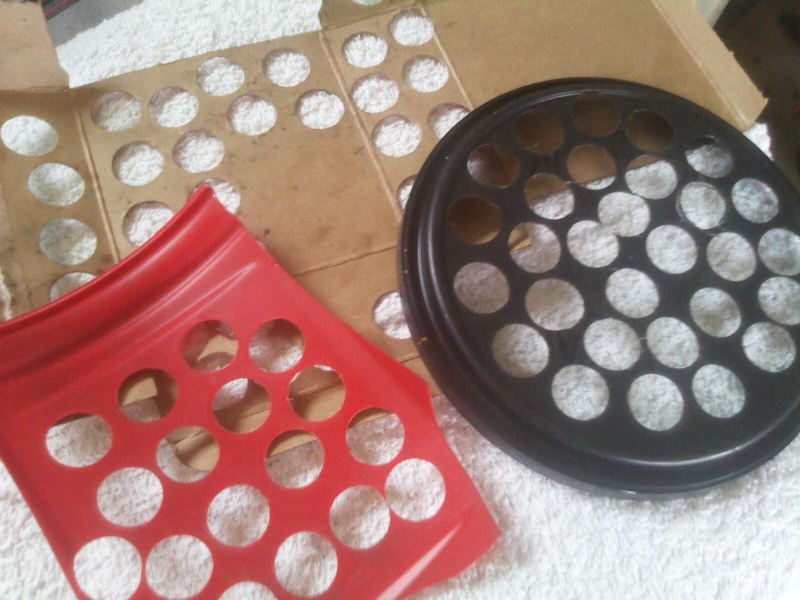

I was bored this morning waiting for some parts to arrive, so I started meddling with making different overshot cards.
I looked for various pipes,tubes fittings that was the same diameter of the interior diameter of a typical 12 gauge hull. I ended up with a steel spacer bushing from something that had the correct outside diameter....all I had to do was dremel around the inside edge to make it sharp enough to cut through cardboard. All it took is a light smack with a mallet to get it to cut out a disk(using a piece of 2x4 as a backer)
I made three variations... one out of your basic card stock type cardboard, one using a plastic lid from a coffee container and the last was using the coffee container itself. The black lid was thinner and more pliable than the cardboard and the coffee container is the most rigid. I'm sure old anti-freeze jugs and such would work just as good.
Using the different colors might help in keeping different loads separated....
A couple pictures of my boredom....

Thanks DW... So far testing on the the reloads I've done have been good...except for a small lot that didn't get much powder. They were more like a small wad/shot launcher than a shotgun blast,LOL. My gut hurt I laughed so much at them....
These overshot cards will come in handy for those hulls that don't want to crimp just right and look like they may dribble shot through the small opening in the middle of the crimp...

Most components in a shotshell are either plastic,cardboard or some type of fiber....and of course lead,steel,etc. So I'm not afraid of a thin piece of plastic or cardboard leaving a residue....but I could be wrong.
I'll tell you what...the Federal hulls I was having a hard time with the crimps on no longer had that problem when I placed a overshot card in them. Smile
I also made some from a fiber gasket material that worked great.

I suppose you can do that. I use them for hulls that don't fill enough to crimp correctly or leave a hole in the center of the crimp that allows shot to trickle out. The overshot card will fill just enough space to to get a good ,even crimp.
