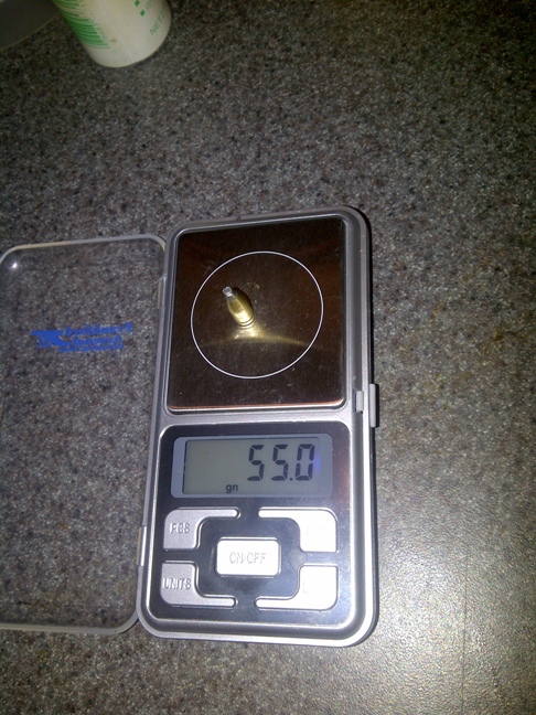

I can in no way afford the dies that turns 22lr cases into .223 bullets so I wanted to try my luck at making the dies and a press heavy enough to handle the pressure. The upside is that I was able to accomplish that, and they were safe enough that I didn't have any unexpected surprises. Keep in mind that my approach was pretty much unconventional to say the least, but was more of a "just to see if I can do it" sort of thing. Admittedly, they are not too pretty and the performance - as expected - sucked!! But, I can say that I was able to load and shoot some bullets that I made. So here are some pics of what you may (not) want to try at home
Dies were made out of cold roll steel that a friend donated to the cause. No kind of heat treatment was attempted. They were made on the small harbor freight 7x12 lathe.
They were loaded into LC97 cases over a light load of 24 grains H335 and cci 400 primers. OAL was 2.200.
They were fired in a Del-Ton Industries AR-15, 16 inch bbl, 1x7 twist. Target was at 50 yards.
So here's the deal - I post these so ya'll can have a good chuckle, but in return I'm looking for tips and tricks that may improve the end result. (I know, the store bought dies would fix it, please refer to sentence number 1
Dies
Bullets and Cases
Final Weight
Loaded rounds
Five shot group - The first shot made was the one that hit the bullseye, and I'm thinking it is gonna be a good day!! It went south from there LOL! The last shot was off the paper to the lower left. Yep, a 6.25 inch group at 50 yards.... if you don't count the one that was off the paper LOL!
All in all I guess they turned out ok for trial and error but I definately want to improve the performance if possible. Suggestions anyone ?

You have a very good start it appears. From nothing to shooting down range is definatly not a failure.
What sizes is your case once you de rim them?
What size is your core after you swage your core with the squirt die?
What size if your seated core in the case?
What is the final size of the Pill after it is ejected from the point forming die?
Not really sure I can help you persay, I am by no means an expert, heck I would not even consider myself a hobbiest at this point but working on it.
Maybe together, we can all work through it.....
I say very great job for going from nothing to something with what you got..
With the prices of bullets now and days, I forsee the day when swaging will come as second nature as loading. Bullet Casting has already rose above and paper patching is making a come back.
Very soon, it will be very common to read about swaging.......

Thanks guys. I have found a couple of things that is working against me. Hawcer, I did as you suggested and chucked it up in the lathe. There is runout at the point, not so much on the ogive as the lead tip. My idea is to make "holder" that fits the ram so as to encase most of the bullet when I straighten up the tip after forming the point. I don't have an ejection system in the ram (yet) so punching them out of the dies may be contributing to the problem. The other thing is the punch that I am using is a little undersized and is pressing more on one side than the other when doing the final sizing back to .224. It leaves a small cupped place to one side which may be contributing to the yaw effect, so I can see another punch in the future.
Another thing that I can't figure out is why the walls of the bullet (bearing surface) is wrinkling up. It's pretty bad until I do the final size on them which I presume irons some of that out. Die not polished enough maybe?
I guess I should add that I anneal one third of the case before seating the core. Makes it easier to do the point forming operation.

Daywalker, Thanks for cleaning up the pics for me. To answer your questions;
Derimmed 22lr cases
Swaged Core
Seated Core
Final Size
I made a couple of 62gr out of some nickel plated cases just for grins. Look pretty slick other than having the runout.

Would you be able to bump that up an extra thousand to make it .224? That may help it engage the riflings better and stabalize it. Then again, I am not sure of your bore size. Were you getting any key holeing?
Daywalker- Admin
- Posts : 2324
Re: Home made 22lr to 223 bullets
May be able to polish out the extra .001. I used a .223 reamer for the final sizing die and did a good deal of polishing on it. I measured some of the bulk bullets that I had bought a while back and they measured .222. I may slug the barrel to see exactly size I'm working with.

I see a couple of things that could have been hurting your accuracy. you should be .224 but honestly a .001 isn't really going to hurt you that bad. I see in your picture that the point is folded back on its self or just looks that way. You can help that by ) Did you anneal the brass after you derimed it?
you will really help yourself if you anneal them. also its better to leave them a little long and on the lead tip you may want to trim that off at 5000+ RPM that can throw you every where kinda like a gyroscope.

Thanks for all the suggestions guys!
The subject of wobble has been mentioned a couple of times and that is the area that I will work on first. So, I plan on decreasing or eliminating the wobble toward the tip by shortning the length of protruding lead at the point or remaking the point forming die if I have to. I am going to make another punch for the final sizing operation so that the base of the bullet is good and flat and square to the sides.
The core seating punch that I used on these has somewhat of a tapered hole in the end so that when I seat the lead it also forms a cone shape on the lead. I'm thinking that if the case doesn't form uniformly around that cone it is gonna give me some wobble at the tip. I'm going to try using the normal cylinder of lead and let the point forming die form it as it needs to. (Shouldn't be much of a task for that monstrosity of a press lol )
I did anneal the brass after derimming, yes sir, that makes a big difference.
I guess that is why they call this the research and developement phase - I do a lot of research and develope a lot of headaches lol!!
I will keep ya'll updated on the progress as I can. Seems like "Me" time is harder to come by nowdays
Thanks again folks, you have been a great help.

one other thing I noticed. and this could be hurting your accuracy more than the bullets you made. You said the rifle you used was a 1:7 twist Man that is a fast twist and you should be shooting from 65 to 70+ grainers in that. My Savage 12 with a 1:9 twist will not shoot anything lighter than a 62. My targets look just like yours when I try to shoot 55 grain store bought bullets out of that rifle.
Reload3006- Member
- Posts : 1761
Reload3006 wrote:one other thing I noticed. and this could be hurting your accuracy more than the bullets you made. You said the rifle you used was a 1:7 twist Man that is a fast twist and you should be shooting from 65 to 70+ grainers in that. My Savage 12 with a 1:9 twist will not shoot anything lighter than a 62. My targets look just like yours when I try to shoot 55 grain store bought bullets out of that rifle.
+1 on this i did not even catch this....

It looks like I would have learned this by now----
Ok, I have some store bought 62gr and 55gr loaded up. I can compare the results of the two, then make some home made ones based on the results of that test. If the heavier home built bullets give better performance ,and I'm thinking they will, I should be able to fine tune from there.

UPDATE::
I have added pics for these--
Since my last post I added a riser to the DTI flat top. I made a new point forming die, a new punch for the final sizing die, and polished out the final sizing die to .224. Made up some 55 grainers without lead tips and some 65 grainers without lead tips. The runout at the tip was all but eliminated so I went ahead and loaded up 5 each over the same charge of 24gr of H355.
Got out this morning and sighted in the scope again using factory 55 gr hp ammo which resulted in a 1 inch group. Not exceptional but these progressive lens im my glasses give me hell. I have not done a comparison between the 55 and 62 gr factory loads yet.
Sent the 55gr rounds downrange first and was mildly surprised. They grouped at 3 inches as compared to 6.5 on the first test. From here I think that playing with the powder charge might close that up a bit.
Time for the 65 grain beauties.. them dudes went ape s--t CRAZY!!
Lit off the first one and it hit 5 inches left and 3 inches low- just did nick the target. Ok, I could have pulled that one, tried the second one - didn't see no hole - grrr. Ran a dowel down the barrel just to make sure that it came out which it did. Looked for the hole again and found it about a foot high. Third one hit 8 inches high and to the right, Fourth one hit high and to the left. Fifth one was a FTF - twice - so the bullet got pulled and the case will be used for the next round of tests.
I managed to dig one of the bullets out of the old cooler that I have packed full of dirt and it pretty much disintegrated. All that was left was about a third of the lead and just bits and pieces of the jacket.
Overall fairly pleased with the imporvement of the 55gr performance though.

What powder and charge are you using for the 65gr bullets? where does your charge sit between min and max? If you are at the min end of the spectrum...they might do better with a little more velocity. It is also possible they might do better at a slower speed if you have a stiff charge already. I notice your 55gr are charged with 24gr...is that also what you charged the 65's with?
My 60's weight bullets are usually at least 1gr less than that of my 50's weight bullets....sometimes even less.
I just looked over Hodgdon's data for H335. 24gr would be near max on a 65gr bullet. Try backing it off to around 22-23gr and retest. Sometimes slower is better in fast twist rate barrels....

Yep, I used 24gr of H335 on both the 55 and 65 grain bullets. I knew it would not be optimal for either one but would get me in the ball park. I agree with your thinking and it sounds like that would be a good basis for the next round of tests. I'm going to have to find some more of the (stinger type) longer jackets though, I only had 7 if them and messed 2 up . I had actually tried making some copper tubing jackets but it is going to take a whole different approach than the 22lr jackets. It is a lot harder to get the jackets off the punch. Could the punches for copper jackets have a little taper to them? It seems like it would make it easier to get the jacket off the punch and would make a jacket that is a little thinner towards the tip. I finally got one pried off the punch and the base flattened out but it was too beat up to use lol!
