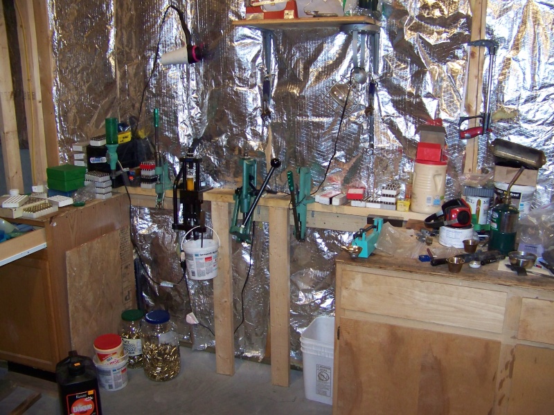

The nice thing about your stand Tommy is that if it is moving you can mount it to the floor. Can't really tell but is yours fixed to the floor?
I know this is not what the OP wants but this is how I mounted mine. Excuse the mess I am kind of a slob. Wink

Post by Daywalker on Thu Dec 06, 2012 8:24 am
The stand in the picture wasn't in it's place at the time of the picture. Now it is where I want it. I did mount the legs to the floor so that there is no movement at all. The second stand, I am going to do some rearranging and mount my RC on it so that I can start swaging again for my .357. I have another RCBS press that is presently being refurbished by me and it will go where the RC was....
