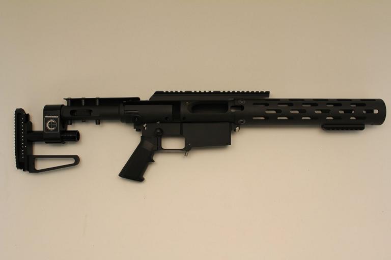

Normally I would do a build like this on a Savage action, for the ease in barrel swaps and I really like them anyway. But this time I am looking to go the Remington 700 route. Not because I truly like them, but because of the chassis system I plan on using with it. All I need is a complete action or donor rifle (short action). Since the barrel, stock, bottom plate, etc won't even be used, caliber specifics really only relies on the bolt face...308 size for 45acp or 450B, 223 size for 300 Blackout. Honestly, If I go with the 300 blk , I'd be better off buying the rifle factory chambered in 300 Blackout. Depending on who I find to chamber and thread the barrel for me...I'd like it to be threaded to be attached Like a Savage system barrel via a barrel nut. Time will tell.
I plan on using an Eliseo "Hunter" tubegun chassis system. It is easily the price of a nice rifle alone...but not everyone has one either.
It will be similar to this, but with a couple things a little different..mainly, it won't have the high dollar stock. But it can accept any AR15 stock I want to put on it.
I don't know what I'll get first...chassis or donor gun. I know where to get the chassis, but finding a donor gun for a price that isn't a complete rip off might take a little longer to find.

I also found this chassis...about the same price, but a little different.

Ohh....I 99% sure I'll be going with the MDT TAC21 chassis. I just haven't ordered it yet, because the magazines I order with it will depend on if I get the 300AAC or 308.

I pulled the trigger on the Tac21 chassis last night with 2 AICS 223 10 round mags.
Yep, that means I found a 300 AAC blackout Yehaw
Now I just have to decide on a stock and optics....and get a 300AAC die set.

Post by hawcer on Thu Feb 14, 2013 10:54 am
Update on progress:
Ammo ready -- check
Nikon Prostaff BDC scope -- check
Weaver steel scope rings -- check
Tacstar grip -- check
Harris type bipod -- check
Tac21 Chassis (should arrive today) --check
2 - AICS 223 magazines (should arrive today) -- check
XLR industries tactical stock (should arrive today) -- check
Remington 700 300AAC donor rifle -- on it's way
Muzzle device -- still to be determined
I have to add:
... that the guys from MDT that make the Tac21 chassis are great to work with and I saved money ordering directly from them and bypassing Brownells.
This also goes for the guys at XLR industries.Great guys that know how to treat their customers They also make a real piece of artwork with their own chassis system. But I already had my mind made up on the chassis I wanted. But their tactical buttstock was exactly what I was looking for and in a price range that I could afford.
I would not hesitate to order anything from either one of those companies.

Post by hawcer on Tue Feb 19, 2013 10:20 am
The rifle should be here today. if I can find the time to go pick it up, I'll have pics up tonight.
The magazines got backordered...so I am still waiting for them. I still have yet to decide on a muzzle device, so the factory thread protector is going to be it for now.
The scope rings I had ended up being too short. I found some that will work...not really what I had in mind, But actually they aren't half bad...They are Basspro's Redhead label and are designed to be peep throughs...but mounted up on this chassis, they look more skeletonized. This chassis really requires the use of AR type mounts/rings that are higher than the usual rifle rings. these are the same height as the M223 Nikon mount I was looking for but couldn't find in stock.
Sometimes you just have to sacrifice a little to keep a project moving along. Wink
Re: I have the itch for another project (300Blk build) Finished pics!
Post by hawcer on Tue Feb 19, 2013 9:10 pm
....And the pics...
