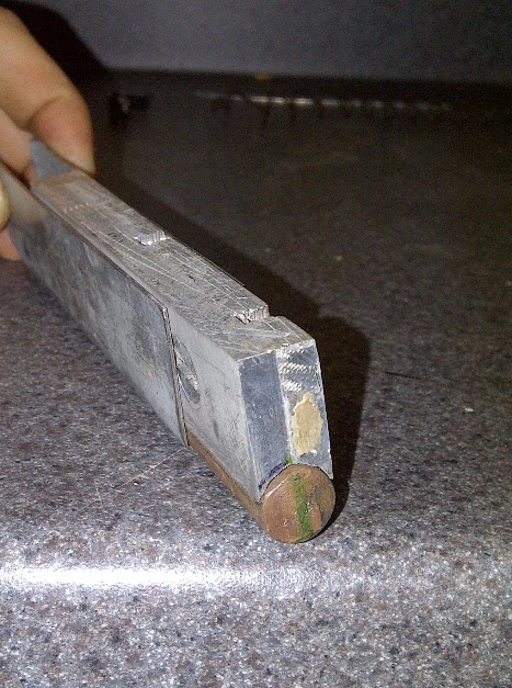

In the midst of trying to cure the problem, I decided to try making my own mag by using the original as somewhat of a pattern. I suceeded in getting the mag made and it worked as good as the factory mag - - feed 1 to 3 and stove pipe the next few. Anyway, I thought I'd share the pics of my little endeavor.
All the parts cut out;
Forming the shell. I used the drill press to push the form into the sheet metal.
Making the follower from a jig made from aluminum;
Making the spring from piano wire;
The end product;
Never finished these but since I was experimenting I thought I'd try a longer version:)

Post by kcatto on Thu Jun 16, 2011 3:36 pm
That is awesome..... good job did you weld the back on?? or just fold and crimp?? and
Did you temper the spring after making it so it would not loose tension???
kcatto
Posts : 648
Join date : 2010-11-15
Location : Oklahoma
Re: Mag Experiment
Post by eagle60 on Thu Jun 16, 2011 5:02 pm
kcatto wrote:That is awesome..... good job did you weld the back on?? or just fold and crimp?? and
Thanks kc. The back was spot welded by a friend of mine. My Lincoln was a bit much for it lol! I didn't do anything to the spring other than wind it around the form. It was a pain in the arse to get it wound, and a pain to get off the form. It took a lot of "finesse" to get it back in line after finally getting it off. If it would have fixed the problem with the Llama feed I would have persued a more long term fix on the spring.
Re: Mag Experiment
Post by kcatto on Thu Jun 16, 2011 7:20 pm
very nice again.... and a job well done.... I really like the jig you made for the follower...
